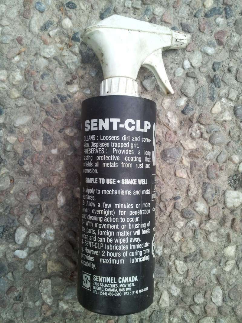

    CLP is CLP22, produced by Sentinel Canada based in  Montreal. They are a manufacturer of Lubricants and chemicals.
    I like it for use on just about everything metal. I used it to free up sticky door latches and lubricate hinges. I also use it to wipe down my rifles before I store them. It has the lubricating properties of an oil, with the penetration properties of liquid wrench or WD-40.
    Here is the link to their web page.... http://www.sentinelcanada.com/html/home.htm
    Here is their sales pitch on CLP22.
    CLP 22 (Cleaner, Lubricant, and Preservative)
    for Weapons and Weapons Systems
    (MIL-PRF-63460)
    CLP 22 is a highly penetrating liquid lubricant especially formulated to combine in one product the functions of cleaning, lubricating and preserving handheld weapons of all caliber. CLP 22 is also suited for various industrial applications.
    CLP 22 contains selected additives providing effective removal of built-up dirt, corrosion particles and firing residues usually considered as abrasive to recoil and gas operating systems. The product has also the ability to form a preservative film layer on cleaned surfaces displacing water and ensuring outstanding protection against corrosion, rust and dirt.
    This unique formulation uses the most advanced technology additives providing outstanding film strength and anti-wear properties, reducing friction between moving parts and build-up of wear debris.
    Effectiveness of CLP 22 has been proven not only as ordnance use but also in a wide variety of applications, including automotive, aviation, marine, and general plant maintenance of industrial equipment.
    CLP 22 is formulated to meet the requirements of cleaning, lubricating and preserving small and large caliber weapons under severe climate conditions from -65°F to +150°F. Contains no ozone depleting compounds.
    CLP 22 meets all requirements of Military Specification MIL-PRF-63460D, Amd 6.
    Here is thier pitch for SENT CLP.
    SENT CLP (Cleaner, Lubricant and Preservative)
    For Weapons and Weapons systems
    (MIL-PRF-63460)
    SENT CLP is a highly penetrating, mobile liquid lubricant which combines three essential functions in a single product: Cleaning, Lubrication and Preservation of handheld weapons, and weapons systems of both large and small caliber.
    SENT CLP provides additives which in addition to their ability to penetrate between metal surfaces, aids in the effective removal of built up dirt, corrosion particles and firing residues which can be abrasive to both recoil and gas operated mechanisms.
    After cleaning, a thin-film layer of preservative forms immediately on the surface which not only displaces water but provides a corrosion resistant barrier against rust and dirt.
