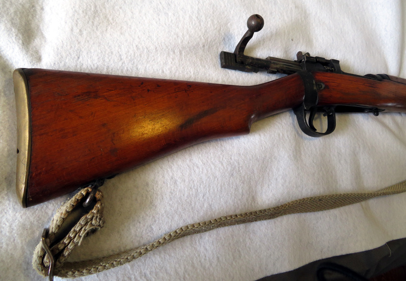

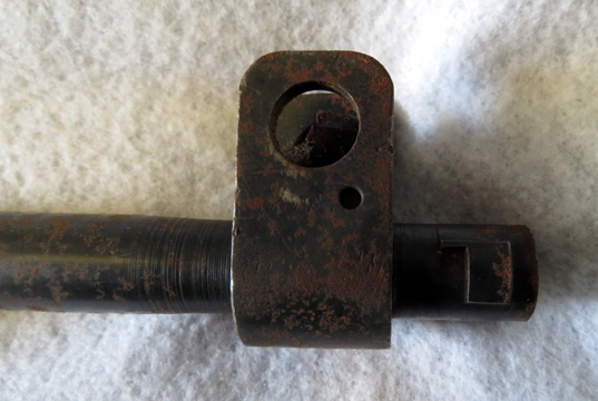

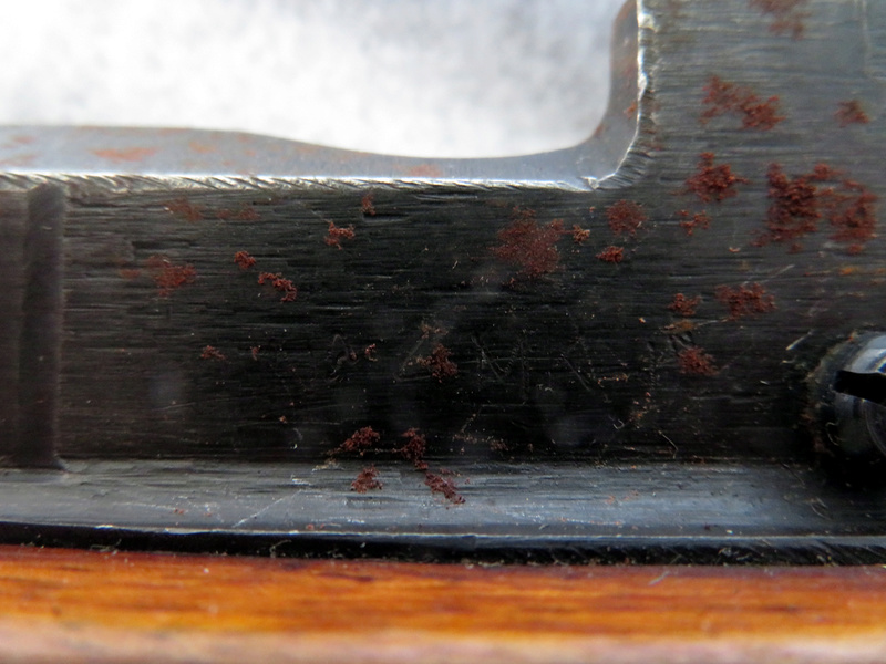

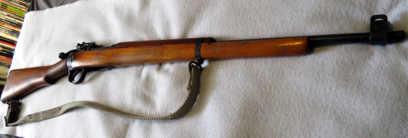

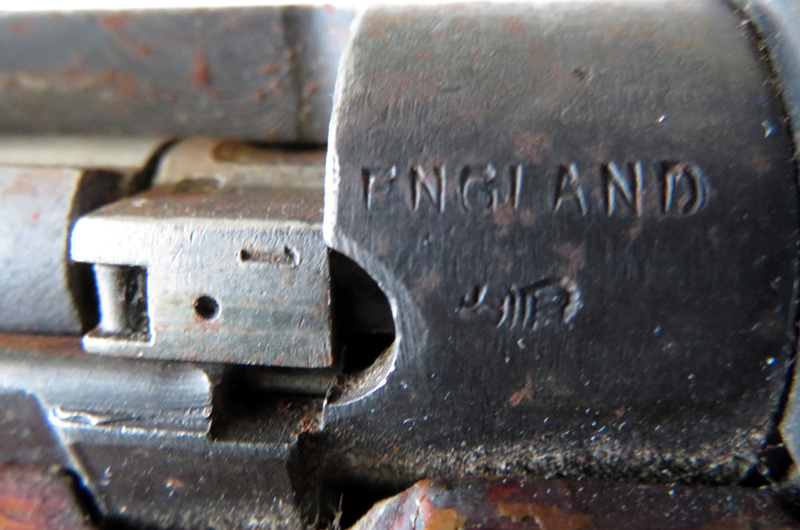

     Number 4 Mark 1.  Picked this up but dont know much about them. It is a carbine but what I have seen listed as a jungle carbine have a bell shape on the muzzle. Clip is missing, are all clips the same? I have an ww1 and ww2 enfield but not sure which clip belongs to which gun as they look the same.  I have a spike bayonet #4 mark 2, is this the proper one or should it be the blade model? Thought I would post it here before cleaning up the rust.  All opinions appreciated. Cheers Brian

    Brian, it's a standard British No.4 Mk.1 and not a carbine. The fore wood has been cut to make it look more like a hunting rifle. The bad thing is that the barrel just forward of the bayonet lugs has been cut. With that cut it can't be restored to full military (ie. by replacing the cut wood with new parts). The Short Lee Enfields ("WW1") mags are a little different. The easiest way to tell them from the ones for the No.4 is look a the back of the magazine. the 'WW1' mags have a ridge running from the top to the bottom. The No.4 ("WW2") mag has the ridge only about half way from the top. The No.4 Mk.II spike is correct for WW2.

    Thank you for that info. Well now I have 3 Enfields that cant be converted back. I have an 1916 with front sight marked PROV. PA 28017/ 5 as near as I can make out. The other is an 1926 with a front sight Parker Hale. No bayo lugs on either of these. I think maybe both clips are ww1 vintage as they appear identical except the more beat up one has extra numbers. The one I thought was a carbine threw me off because the wood was cut down the same way as the carbines and the lugs were still there. Shame they cut a wee bit off the barrel. I now know a bunch more than I did, thanks again. Cheers Brian

    So they saved maybe an inch or less as the bayo lugs are still there. Hardly worthwhile to mess up a rifle. Oh well it is what it is. Cheers Brian
